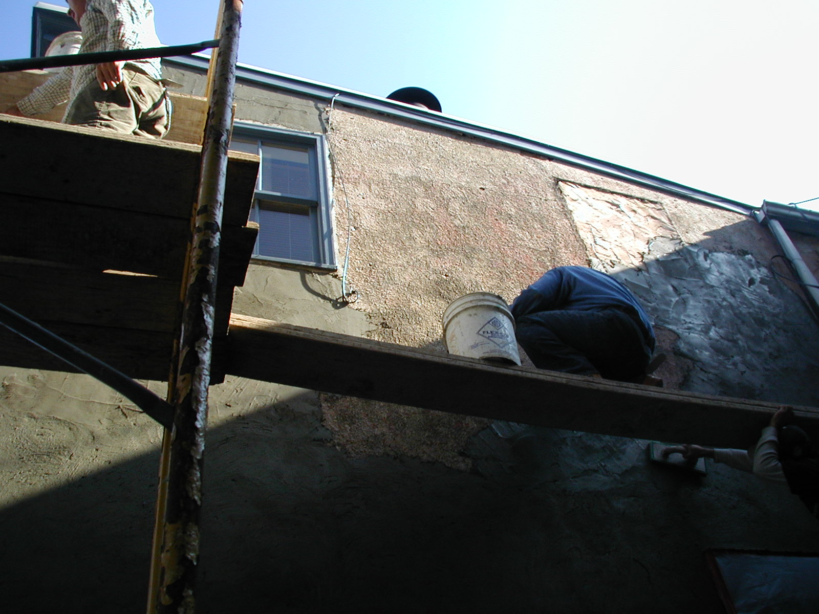

By the time I got back with my camera,
 this wall was already torn off.

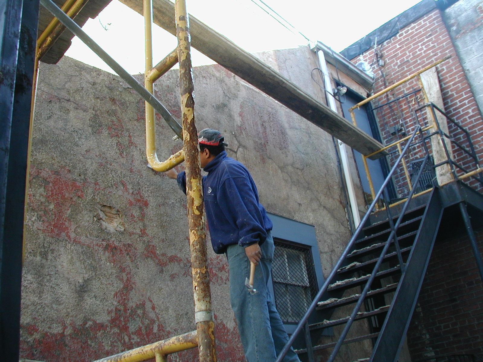

Plaster weld was painted on the old painted stucco and
 the new layer
of stucco was loose and popping off.
It is real embarrasing to think we used these bonding agents years ago,
and all the work we did is loose and popping off. I stopped using these
bonding agents when I discover work we had done 10 years before
was already failing. I felt we were doing the customer a service by
saving money. All I can say is I'm sorry, I just didn't know, even though
it is a frequent practice to use them.
The practice of using these bonding agents still goes on here in the
Washington area and I'm sure other places. If you are a plasterer
using this method, I suggest you stop immediately. I have seen
buildings around Washington that are pink(or blue) with bonding agent
and the stucco has popped off, or was scraped off. Pretty sad for
what should be a permanent application. If you want evidence, write
and I'll send you addresses you can ride by and see.
