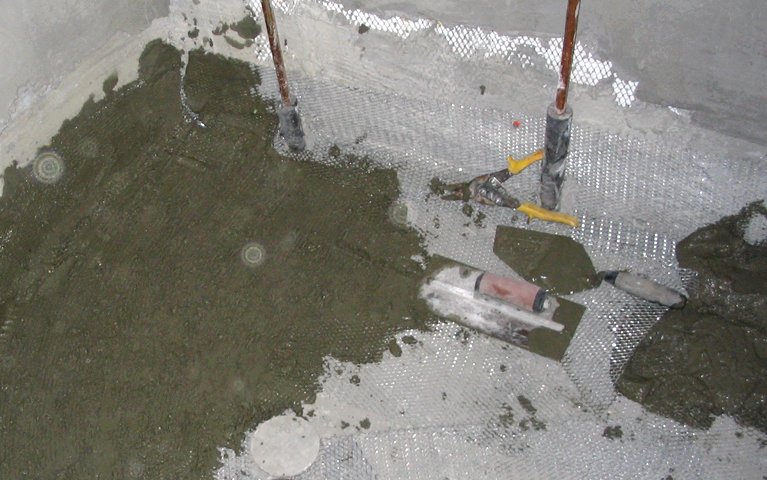

Stucco shower floor in Washington, DC
Drain is covered with tape. Finish coat overlaps the edge of the drain. Tape is removed before the finish sets up all the way.
Never nail through the floor !
The most important thing is to never nail metal lath through a rubber shower membrane. There is no need to nail metal lath to a floor, the force of gravity will hold it in place. If the lath doesn't lay flat, it can be tied together where it overlaps with tie wire.

We worked on a house where a tile contractor put in a mud base (cement mortar) floor. They nailed the lath through the rubber membrane. When this shower leaked, it ruined my new color plaster ceiling in the kitchen, as well as the natural color cabinets. Another critical observation is that the drain must finish just below the finish coat. Some of these drains are adjustable with screw threads. Ideally, the base coat should finish flush with the edge of the drain, and the finish coat should slightly overlap the edge. A stucco shower achieves an appearance one can't get with tile or any other material.
